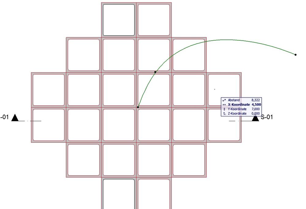

How was this acheived ?
i just read on the graphisoft website about this .
http://www.graphisoft.com/community/press_zone/jury-biotechlab.html
looks fantastic but im very curious about how he formed the base and ergonomic columns tieing into the main biulding structure ?
i would be very interested to see what would be the strategy to pulll this form off ?

1. Slab with hole
2. Multiply slab
3. Add Shell for SEO
4. Hide Shell and there you go

ok i had a few minutes to try this.
for the shell part.
i was able to first select a surface on the side from one of my boxes, to allign starting view.
then i created the free form shape.
extruded the shape using the shell option 360 degrees.
placed it on the a new level.
used SOE solid object editing to subtract the new form from the boxes.
turned it off and BINGO there she is !
my only problem is.
i would really like to be able to go to a section view, draw my shape exactly for the extrusion and then make my shell.
But i cant work out how i can make a good profile in section and then use that for my shell extrude. at the moment it is just all loose in 3d view mode.
thanks guys.
Ian
pixpast, you're almost there!
missing part for you:
1. in section draw contour of shell with spline tool (or any other line tool)
2. copy that line and paste it on the floor plan
3. with shell tool active space+clik that line and finish shell as you want...
ok have my spline set up in section.
DONE !
little problem.
when i have my spline on plan.
i select shell tool.
then i select the correct option of shell tool.
go and space select my spline line and i get this horrible error message ?
eeek, what am i doing wrong ?
Thanks a lot.
