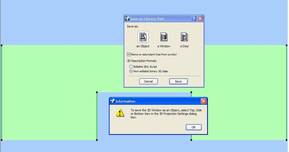

Guys, I did what you told me, but as soon as I wish to save it as an object, I got a warning
...wich I dont understand, since I did made parallel projections and top view, as you can see in the picture
...on the other hand, door and window option works with no problem.

Link, I agree with you, but I want to know more on storing/creating object.
...and still I dont understand why do I get this warning?!
Why I cant save it as an object?!

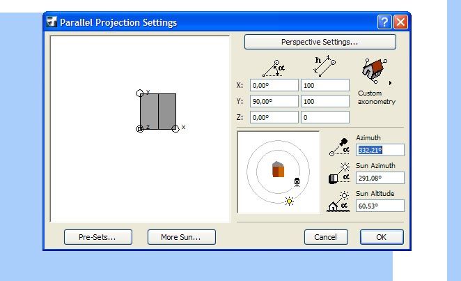

Here are the settings for the view
according to Karl's picture your azimut is wrong.
AFAIR (;-) to Djordje )....a small angle makes trouble
Try to change the azimut to 90 may be it will work out
Cheers
Jean-Luc
That wasnt the issue,
look at my picture up, even thou I have first select the top view and then modify x,y, to 0, 90 deg. the icon was switched to CUSTOM AXONOMETRY --> problem
