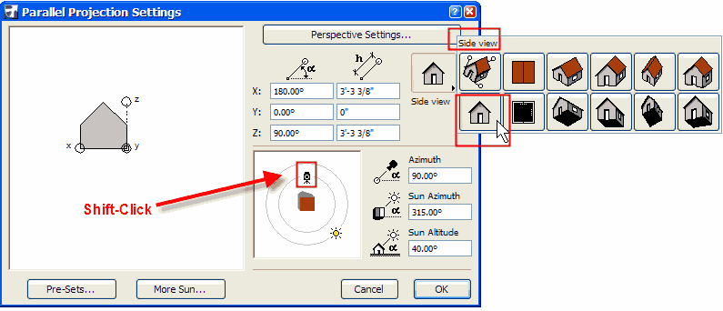

When you save the 3D window content as a GDL object (not window or door, but object), the view/angle of the 3D window represents the plan view when the saved object is later placed.
Thus, if you model the arched object as a slab, with the base towards the bottom of your monitor...then do NOT view as top-down in the 3D windows. Instead, view as SIDE and shift-click the camera so that the side we are looking at is the side at the top of your screen - as seen in the attached screenshot. Now, simply use File > Libraries and Objects > Save 3D Model As ... and when you place the resulting object it will be "standing up". No editing required.

Here are the settings for the view
according to Karl's picture your azimut is wrong.
AFAIR (;-) to Djordje )....a small angle makes trouble
Try to change the azimut to 90 may be it will work out
Cheers
Jean-Luc
That wasnt the issue,
look at my picture up, even thou I have first select the top view and then modify x,y, to 0, 90 deg. the icon was switched to CUSTOM AXONOMETRY --> problem
