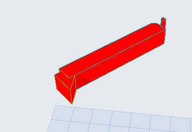

I am trying to make a beam with a strange end shape.
Even if you look at it in 3D view, it does not become a single beam.
how do you guys use it?
Looking at the odd shape, it doesn't work out on a flat surface.
1. The most important thing is to have an accurate shape on the floor plan.
2. Is it possible to have one beam in 3 dimensions?
B.
In the 3D view, SOE seems to have a problem with ADD as shown in the picture above, but there seems to be no problem with Subtract as in this image.
But in plan view, I want to know how to handle it.

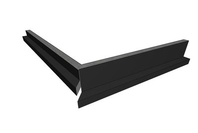

Create a beam with a thickness of 1mm and set it as the end plane. Put this beam in a hidden layer and you are ready to go.

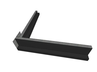

Just place the end beam at the right position. You might need two, one for each beam.  Then put the end beam in a hidden layer.

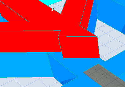

LeeJaeYoung

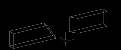

Barry, I know that the left side is possible.
But the right side didn't work. Is it possible?

That is why I am proposing an extra dummy end beam. You can rotate is end set according to your needs you can even set it inclined and rotated as well.
this will create the end of your main beam.
Maybe you can also create the and with a column that will have the shape you want.
