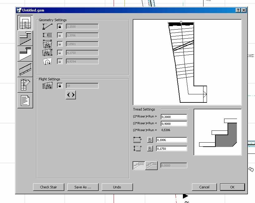

I now have two problems:
First see attached file, why it doesnt let me change the run ? I want it to be 0.28m and it says 0.18m although you can see there is much space. And I changed the Tread settings that controls the relation between riser and run and still it doesnt let me have a run more than 0.18m
Hi Wendy,
For your first question: have you tried unlocking the total length and width parameters?
