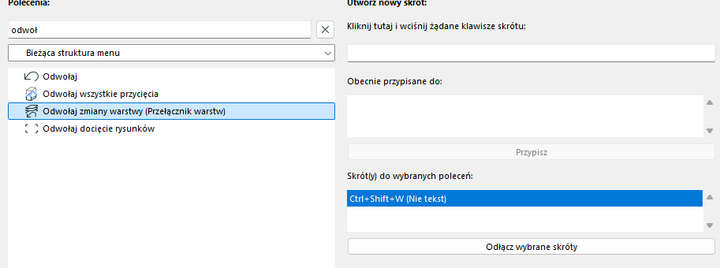

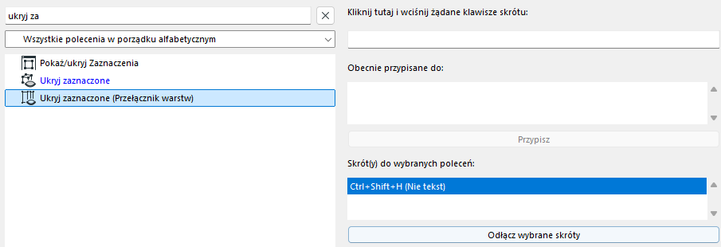

Our workflow is to put them onto a specific Layer and then use Quick Layer Palette's command Hide Selection's Layer mapped to a shortcut (Ctrl+Shift+H) to quickly turn it off when working on a Floor Plan. Then using another shortcut (Ctrl+Shift+W - Undo Quick Layer Actions) we can bring it back if needed.
(Screens are in Polish - sorry for that - but you get the idea hopefully)
