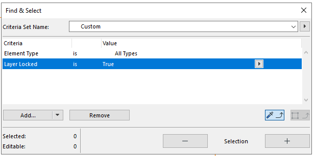

Earthworm
I don't understand the complaining, this is easy...
Ctrl-F ->
Element Type is [Whatever you like]
Layer Locked is [False]
Voila...
undefined
ArchiCAD 27 | Intel Xeon W-2225 - 4.10GHz | 32 GB RAM | GeForce RTX 3080 | Windows 10
@Earthworm wrote:
Ctrl-F ->
But then it is not a simple case of dragging over an area to select everything.
Fine if you are selecting everything on screen, with the added step of opening F&S and creating or loading the criteria, then selecting.
If you want to select in just a specific area, you would have to place a marquee an add that option to you F&S criteria.
All good, just extra steps to select exactly what you want.
But as I said, even though you sweep over an area with locked elements, they will select, but they will not move or delete.
So effectively you just ignore them.
