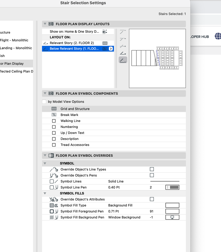

I'm having an issue with the stair tool
McCad
When I go to the stair setting and go to floor plan display every time you choose the break line with hidden line either top or bottom the hidden line show a block like pattern don't see how to remove that.
Screen Shot 2023-08-09 at 9.46.48 AM.pngScreen Shot 2023-08-09 at 9.47.16 AM.png

Xandros
Hi
Did you check those settings in your stair?
(Screenshot is from GER-Edition)
Weirdly enough, if you feel like an option might be missing, you might switch the library object to a different object and then back to the first object. One of those marked linetypes reappeared for me after i switched between those two library objects...
ArchiCAD 27 GER / Win10

I did not know about this option thank you
