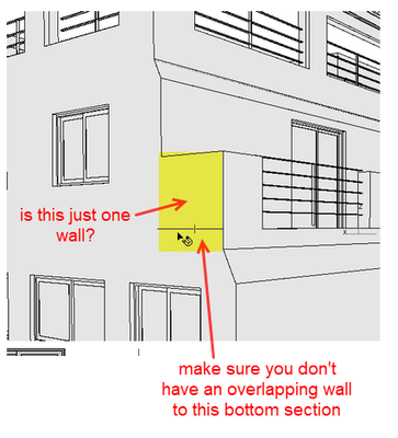

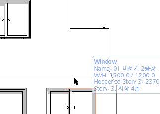

I'm trying to drill a hole in the railing wall.
1. When working with the opening tool, opening should not be turned off in the MVO in the structural drawing.
The lower part of a window is an opening in the lower wall.
2. If Window is empty, the window is removed from the MVO in the structural plan, but it is not removed.
AC27 on window 11
18 Replies 18

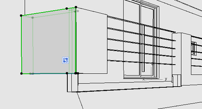

LeeJaeYoung
I gave up after struggling because of this only visible in 3D view.
This line is not visible on the elevation.
BIM seems really tough.

Make sure you do not have any overlapping walls.
The surfaces will heal in elevation if they are the same surface material, but you may still see joins in 3D if walls overlap (i.e. 2 walls in the same 3D space).
Touching or joining is good, overlapping is bad.
LeeJaeYoung
Deleted wall.

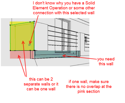

I am not sure why you have deleted the wall along the bottom front of your railing.
You need that wall.
It is the wall on the side where I thought you might have 2 walls overlapping.
They can be two separate walls that touch or it could be just one wall on the side.

Always try and keep all skins as one wall if you can.
Otherwise you have 2 walls to move and cut holes in - remember a window or door can only belong to one wall - you will have to cut an opening in the other wall.
LeeJaeYoung
I removed it just to let you know which walls are influencing them.

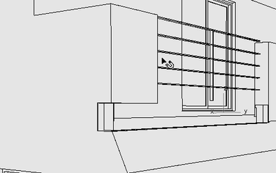

LeeJaeYoung
Solved, but sad.
It was done a long time ago.
Is this now the solution I want?
Thank you so much! ^^
AC27 on window 11
Don't be sad. Be 😀
It looks good from what I can see.
The top of the walls don't match.
But that may be because they are different composites or complex profiles.
You can fix that if you want by overriding the edge surface of the walls.
