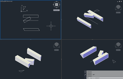

I want to do this Extrude Path, but what should I study?
In Archicad, only those perpendicular to the plane seem to be extrude...
Solved! Go to Solution.

@LeeJaeYoung, you can see the the attached video for your reference. Hope it helps.
2022-05-23 04:00 AM
You can use Morph, create the plane then in your pet palette use tube to follow the path.
2022-05-23 04:07 AM
This might help explain morph surface tubing a little more...
2022-05-23 05:31 AM
I'm talking about the extrude at the bottom of the plane.
(on the top left)
I can do an extrude path perpendicular to the plane.
2022-05-23 05:34 AM
The extrude path I'm talking about is not perpendicular to the face.
It will be easier to understand if you look at the answer above.
Is it possible?
2022-05-23 07:27 AM
Sorry, I don't understand what it is you want to extrude.
You can either create a morph surface and extrude (tube) that with the pet pallet option.
Or you can create a complex profile that you can use with the wall, beam or column tools.
Either way the profile you create will be a cross section at right angles (perpendicular) to the path you extrude.

2022-05-23 01:30 PM
thank you so much.
Archicad seems too difficult to learn. ^^
I couldn't find this method in a video tutorial.
Thank you again.
