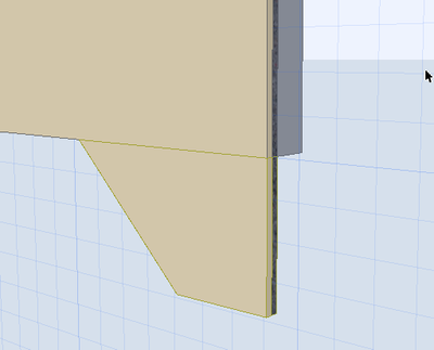

I want to morph only the finishing and insulation parts to the composite wall.
1. Combine with SOE and turn off the Morph layer so the borders are still alive in the elevation.
How do I do that?
AC27 on window 11
1 Reply 1
LeeJaeYoung
Archicad is not just an addition to the finish
I found that if I create a new wall at the bottom, create a new wall with it and SOE, and intersect it with morph, and turn off the morph layer, they will combine with each other.
The concept of Archicad is different.... ^^
