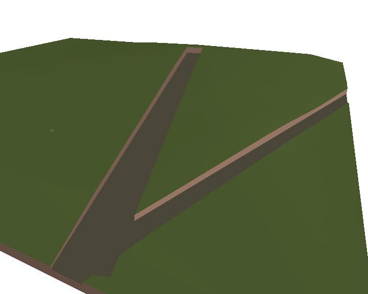

I`m trying to insert the road on the irregular site.
I found a tutorial but it was using a slab. In my case, the roads aren`t straight and plane. They follow the terrain mesh.

1. Set a slab the plan shape of the road.
2. Using SEO set the slab road as the Target and the site as the operator. The operation set to INTERSECT. This will trim the slab to be just where it intersects the mesh and the top will mimic the mesh irregularities.
3. Now using SEO set the mesh as the target and the road/slab as the operator and subtract with upwards extrusion.

Sorry... I try that Erika, but all I get it is this image below...
What I am i doing wrong\\??
Thanks a lot
OHHHHH now I understand/... is the thickness of the slab that shoul be higher that the site mesh....
THANKS A LOT Erika...
