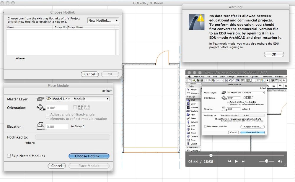

I'm having problem with the file [COL 06.pln].
I'm working on the ITG Chapter 06 on an International Education version [on mac]. A warning message comes out [ see attached ] when I tried to hotlink the bath.mod into the COL 06.pln.
I've resaved it as it says though it's strange as the file is already in edu mode.
Can anyone help?

I think you will have to open the MOD files (Module files) one by one in the EDU version and save them. This way they will be converted to EDU version.
The idea is that all ArchiCAD files must be EDU version, all PLNs and also MODs.
I think in Chapter 7 will have to resave some MOD files too.

Thanks !... I got to resave the mod files but now the problem is there is no drawing on it! I've extent to fit and it's blank. The tutorial is showing a washroom plan.
