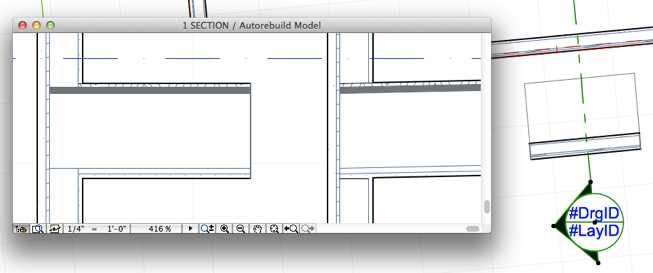

I was asked by a client to troubleshoot a section in AC17, since the walls did not clean up in section to the deck.
After some testing, I found that the new Building Material-based intersection management seems to only work for walls meeting slabs. In this case, the deck is sloped so it is done with a composite roof, which meets a lower wall and a parapet wall.
Here is an image of the original model intersection along with a copy of the same walls meeting the same composite when placed as a slab instead of a roof. In the case of the slab, the intersection cleans up pretty well in section.
When the roof meets the walls, it doesn't clean up at all with the new building materials. The best I could do is to use Solid Element Operations (as seen in the image), and even then, the roof sheathing sticks into the wall rather than stopping at the core framing of the wall.
When I tried using the Connect command, the walls got trimmed back to the edge of the roof, which only extended to the outside of the core; thus the walls then lost their sheathing, which looked totally wrong. I tried moving the roof pivot line to the outside of the wall face, and changing the Trim to Roof option in the Roof Settings to Pivot Lines Down, but that didn't help restore the wall sheathing - it still was removed by the Connect command.
Does anyone have any better suggestions for getting a good cleanup with parapet walls meeting roofs in AC17? At this point, it looks like one will need to use SEO and then a patch to clean up the intersection.

Thank you so much for posting that information! I was unaware of the Connect > Merge Elements command.
I was able to select the two stacked walls and the roof in section, and use this command, and they cleaned up exactly as the slab example did! Hooray!
In this case, there were no issues with Intersection Priority Numbers of the skins having values that did not progress properly from weaker to stronger. However, your explanation of this potential issue is important for troubleshooting composites that are created by users or migrated from previous versions of ArchiCAD.
Eric

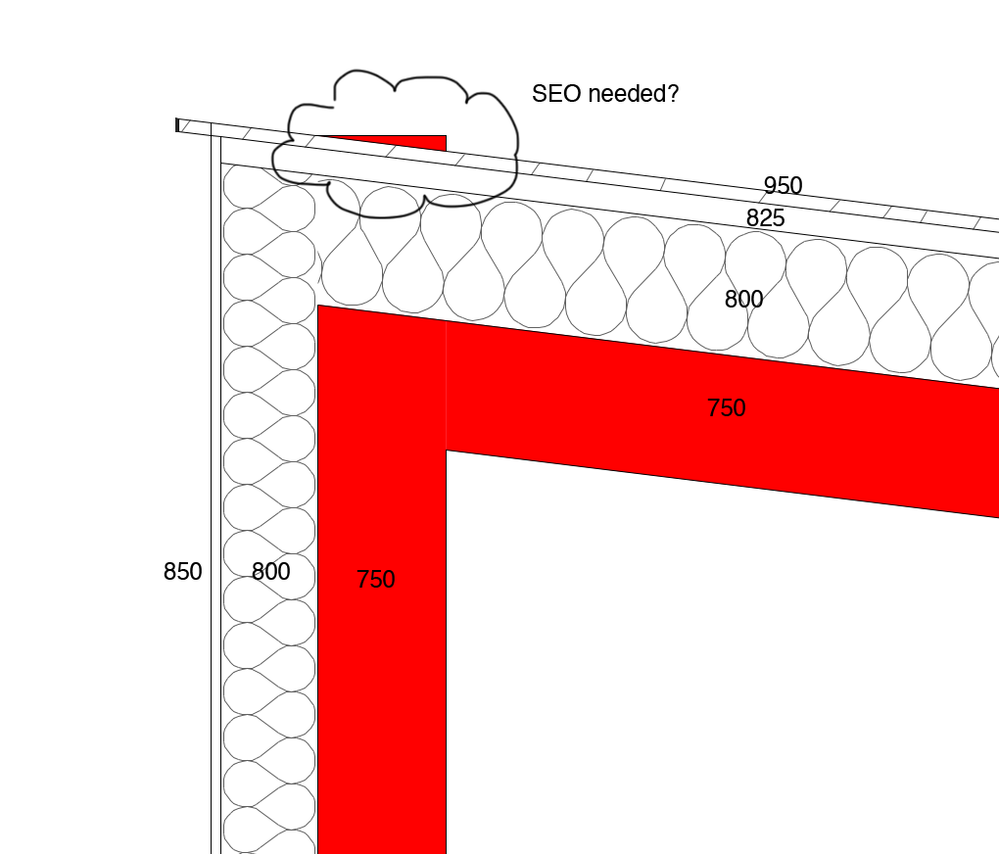

Hello,
I can't seem to get these roof/wall connections right. Using the new merge tool, here's what I can do. I added the priorities on the picture.
What I would like AC to do is connect the concrete together and get the insulation all around the exterior of the concrete.
What am I doing wrong?
Make the Intersection Priority Number of the insulation's Building Material stronger that that of the Concrete.
I tried it, as you can see. I'm almost there, but not quite. What's the next step?
Also, it seems weird for the rest of the project to have this priority logic: insulation higher than concrete. Would it be common practice to use two different insulation materials with only priority varying?

you need to make the the external render a higher number than the concrete too, so that it cuts it correctly.
It takes some getting used to for the PBC logic but yes, you will need different insulation (and other) materials for different situations. they can have the same properties but with different PBC numbers.
It seems complicated but once you have your materials list set up it should all come together and will be powerful in creating correct junctions.
I would love to see people sharing materials lists.
For your project I would create a roof insulation material and a wall insulation and external render materials. The wall insulation and render materials would have a higher PBC number than the concrete the roof insulation material. I would then bring the height of the wall up so that it is set to the top height of the roof. This way the insulation and external render will continue up to the top. Your roof finish layer can be higher than everything else.

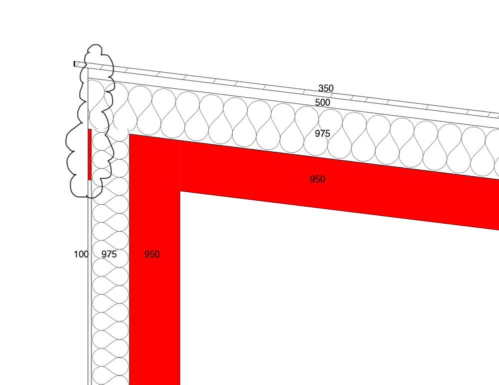

Attached is my new material PBC strategy. It works but requires a further SEO. I imagine that last step (which nonetheless makes the connection perfect) makes calculation slightly longer. Is there a way to avoid the SEO?
On another hand, now that I have different concrete materials for different priorities, all using the same solid red hatch, a line appears at the intersection between them.
