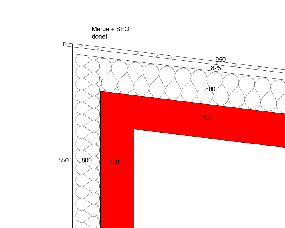

Here's the junction working
Thank you very much for your help!
Instead of using 'Connect > Merge' and then doing an SEO try using 'Connect > Trim Element to Roof/Shell'.
This will do the SEO staight away.

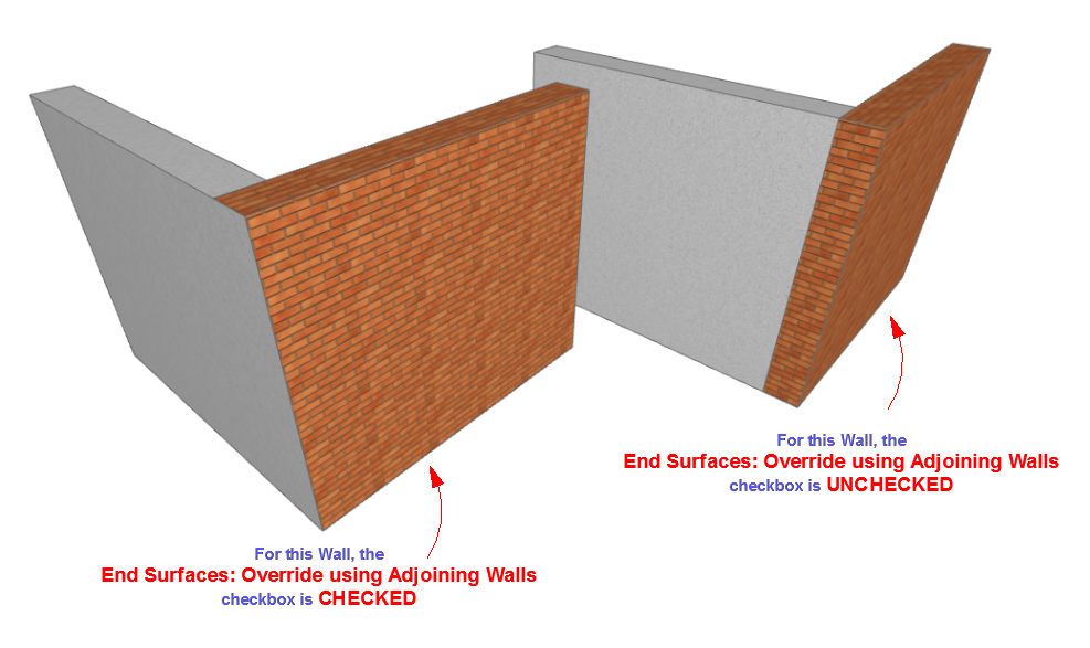

One thing to enhance L-joints is a new checkbox in the Wall Settings Dialog called End Surfaces: Override using Adjoining Walls. If it is checked the edge of the Wall will use the surface of the Adjoining Wall, even if it is the stronger Building Material. Check the attached image for explanation.
