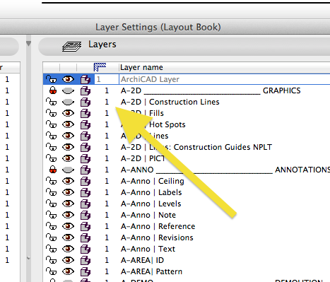

I checked everything and it all looks good: The fills are the same on wall, beam and roof. I'm sure the the three of them collide perfectly.
Attached is a test will a simple rectangular beam (not a complex profile), using the same red concrete fill. the junction still doesn't work.

Check your renovation status and layer intersection settings. One of the two might be the reason for the line.

The renovation status is the same on the three elements (roof, wall, beam).
Layer intersection settings.. Where can I find those?
Eduardo Rolon
open Layers and see attached. If the layers have different numbers the same fills will not clean up.

THAT WAS IT! What a relief!
Now, I'm wondering what's the standard use for that function?
Eduardo Rolon
prior to the renovation filters it was used for DEMO plans and it is useful to separate items that are the same in section or elevation that you don't need to clean up.
take in consideration that the numbers are saved in the layer sets so you will need to update those too.
