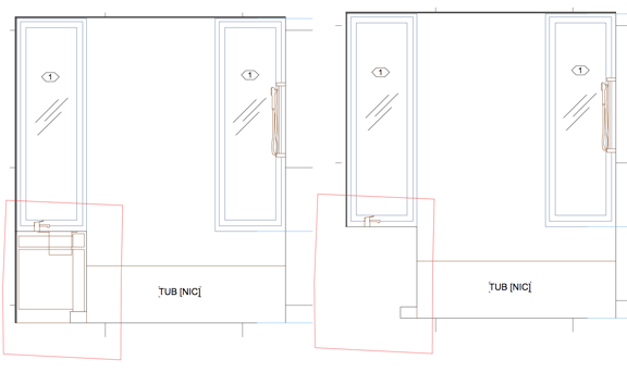

Interior Elevation Cut Objects are not correct
The image on the left is what we get with interior elevations, and the image on the right is what we want. I've put fills and lines on the right image to achieve the correct look - but is there a way that archicad will produce it for me instead?

if you model the cabinet as a solid thing then when the IE marker 'cuts' through it you'll get what you want?!
Thanks for the suggestion - but it will then still show the lines around it - including the line at the wall/back of cabinet.
And if I model it as a solid element, the cabinets/drawers won't show up in the int. elevations, and I would still have to do linework.
Maybe archicad just isn't "intuitive" in this particular instance.
Erich

the way i'd mask it is marquee over the affected area (as close as possible to the cabinet inside the room, but overlapping the outer lines), then go document>document extras>create patch. this will create a 2D patch object over the area, which you can edit to remove the linework you don't want... the benefit is that it is editable and reusable anywhere in the file as long as the shape you're trying to patch is the same shape. it does mean however that it does not update with the model... so in that sense it's like what you've done but in an object form...
we use a patch specific layer for these 'patches' (remember, they are object and will have a layer assigned to them) and we save them in the project library folder (they are library parts after all)

Here is a tip you can try:
Create in the Profile Manager a Profile of the Counter. Assign this Profile to a Beam and place a Beam there.
Then use SEO to subtract the Beam body from the Zone.
Place the Beam on a hidden wireframed layer so it will not get into the view later.
Then in the Interior Elevation Settings Dialog, set the IE to get its height from the Zone and to take SEOs into consideration.
Let us see it that achieves what you are after.
Edit: I tried it in the meantime. It should work.
laszlonagy - Genius! I think that will do just what I need! I frequently forget the usefulness of the profiler. Thanks for the tip and I'll let you know if I have any further issues.

One thing: When I did this SEO between the Beam and the Zone, it gave me some error message when regenerating the Interior Elevation. I just clicked OK and then it displayed it just fine.
