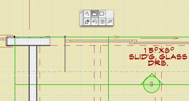

Is their a way to limit the Interior Elevation Depth? The automatic IE generates a view to the furthest wall, while I would only want to show up to a certain depth.
Does anyone know a command that can limit the depth?

I might be off track, but try to slide/stretch the 'limit line'...it can stretch to meet your required distance/depth.
No. I've tried to stretch the limit line but it does nothing with the depth of the horizontal distance. I was hoping that the interior elevation is similar to the elevation or section markers. I only find the limit line dictating the distance from left to right and not the depth.
Strange, I was able to adjust depth. Just like how it shows in the image I posted earlier.

The IE tool unlike the Section and the different Elevation tool do not have a horizontal limit. The IE will continue until it hits a wall. There are workarounds the easiest is not to use it and use a regular Section…

Just to clarify..I am using the interior marker tools and have been able to adjust depth. I suggest the same as Peter and visit James Murray's site.
I think I know why you can't adjust the depth. It probably has to do with the geometry method you are using.
I should make a note (I just noticed) that you cannot stretch depth when you use/insert the marker as an individual...it should be as a group....so use methods 2, 3 or 4.....and the ones that you don't need can easily be removed afterwards....which is also further explained in James Murray's site.
See attached image for a visual: ( I apologize for the extremely big image...don't know why its shown that way )
