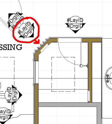

I've placed interior elevations (v.11) into my model and most work fine but out of 12, there are two that do not display a wall that is right in front of them, but it's as though the wall weren't there - it shows what's behind the wall.
I've tried moving the IE marker and limit lines, I tried placing it individually and as a group. I've cut and pasted the wall, deleted it and put in a new wall and always with the same result. The wall displays fine in 3D or in section.
Naturally this is for a deadline that's today which I'm obviously going to miss....
The first image is the plan and marker, the second is the elevation I get.
Any help much appreciated!!!

the result - it just occurred to me that it's not displaying ANY of the walls - the windows in the background are off to the lower right on the plan above, but of course it is showing the little hooks on the wall

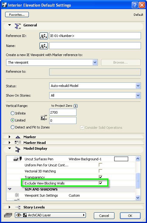

Maybe it's because of this setting....
Cheers,
Link.
We had this problem in our office too- we found that that setting was the solution as well.
I find that when you are having a problem , and you can't figure it out- try every setting in the dialgue box and you will find it.
The answers are almost allways right in front of your eyes.
THANK YOU!!!!
That was it, as you said Jess, right in front of my eyes. I'm not sure why anyone would use it that way, but I'm sure there's a good reason.
