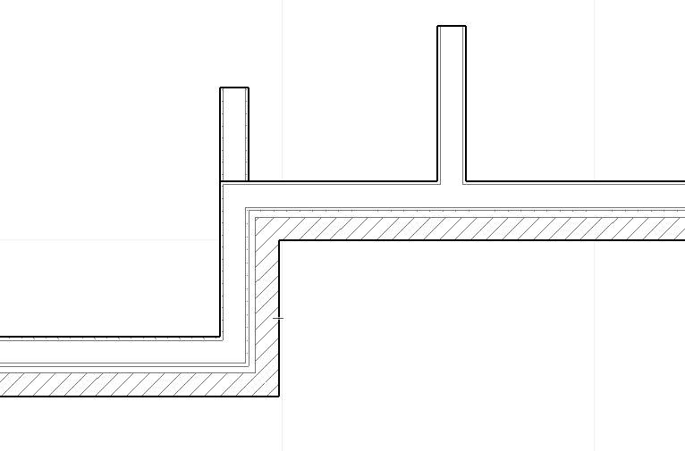

I've searched all over this forum and all over the internet and I cannot find the answer. I am a drafting teacher planning on teaching ArchiCAD soon in my class. I am also brand new to ArchiCAD.
In the picture below I can get the interior wall to attach to the exterior wall in the middle of the exterior wall. But I am having trouble attaching the interior wall at the exterior wall corner.[/img]

You have your reference line on the external face of the wall.
I have always placed the reference line to the internal wall face so that your situation always cleans up.
Rod Jurich

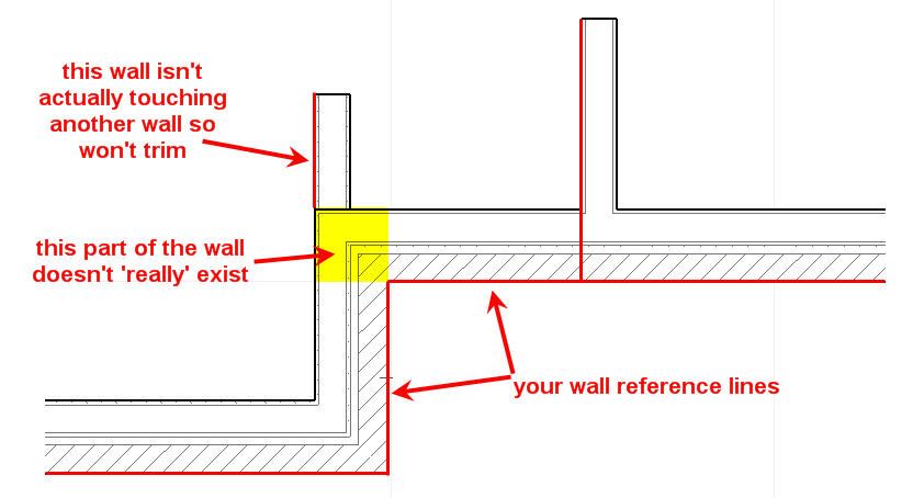

As Rod said it is all to do with the reference lines.
If you turn off the "Clean wall and beam intersections" option you will find that the corner of your external wall doesn't actually exist as the walls are really only as long as their reference lines.
Therefore your internal wall at the corner is not actually touching any other wall and will not trim.
The wall midway along the external wall is touching so it does trim.
So move your reference lines of the internal walls to the inside as Rod suggests.
It is an extra step as generally you will model those walls using the external dimensions (unless you use an offset) so you have to place them and then move the reference lines.
But you only have to do it at these corner intersections.

That works. Thanks for the help!
