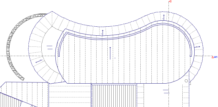

Hi
Thank you!
Like you see on the picture.
It is a house where the second floor is smaller than the first floor.
So the slab on second floor sticks out to be a part roof on the first floor.
I am trying to do a chute on the roofs because I dont want to have a hanging gutter.
I did a SEO on the roof with a custom profile and we can se it in floorplan.
We can not se the one one effectuated on the slab.
Too bad
i guess i have to draw lines other way I will have to redraw all the roof on the first floor.
Instead of adding lines can you just leave the SEO operator showing on plan to indicate where your "chute" is? Turn that layer off in 3D views to show its effect when subtracted.
Hi there,
I think the error lies in the workflow you're using ( not bad, but it follows a different logic, the logic of free form modeling)
Try a different approach:
Keep the slab for you slab/floor up to the limits of the Envelope, then create a separate element for the Roof.
The second element - the roof - can then be done with a single Morph by "morphing" your existing roof ( so you don't loose what you already did )
If you are in a higher level of detail, then you should consider modeling it closer to what construction would be, maybe one roof for the top geometry and a slab for the soffit / ceiling?
In this way you don't have to "draft it" it will be all done with native AC elements, and the Plan representation will be correct.
