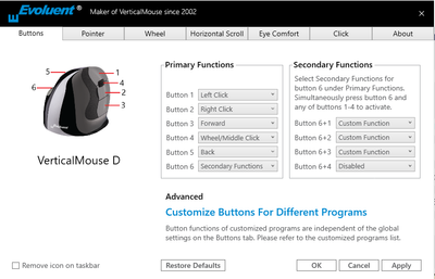

as with Rye's response, i use this Vertical Mouse from Evoluent
I'm able to input macro commands pressing button 6 and another button.

for my left-hand mouse, i use a Logitech G903 & i can assign macros to whichever button i want
it's like a multi-layered combo of macro & shortcut. your mouse button activates keyboard keystrokes which AC interprets as a keyboard shortcut.
  • assign a keyboard shortcut for Pan
  • go to your Razer software & set up a macro for said keyboard shortcut
  • associate that macro to your mouse right-click
  • profit
