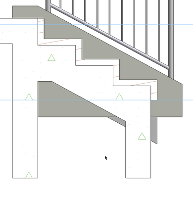

Why is there a stair finish in CORE ONLY?
LeeJaeYoung
Q4. Why is there a stair finish in CORE ONLY?
AC27 on window 11
1 ACCEPTED SOLUTION
Solution
Andrii Levko
Hi Lee
Because at the moment you have probably library object for Tread and Rise. To have Rise and Tread hidden with Core Only, you need to set it as profile. Archicad has the default profile "Stair Tread 300 for Riser Slanted 150", and it is set "finish" by default.

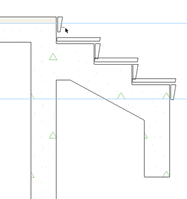

When I do as you said, the above happens.
How can I solve this?
AC27 on window 11
It seems to be intersectional issue. Maybe you have hide some element with stronger priority.

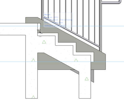

This is just a change.
AC27 on window 11
I think graphicsoft can solve it with IF statement in gdl enough, but I was wondering why they didn't solve it until now.
why why why ^^
Built-in Tread or Riser
IF GLOB_STRUCTURE_DISPLAY <> 1 THEN
call "basicStairTread_m" parameters all bOverrideStructureSurface = ac_bOverrideStructureSurface,
treadSurface = ac_treadSurface
ENDIF
AC27 on window 11
It's a bit strange. Looks like a bug.

I meant your screen with the wrong height of the top rise, when you switch on "End with Riser". Looks like a bug.
