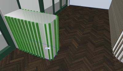

I’m trying to create a simple cladding made of vertical slats with fixed spacing. However, when the Reference Line changes direction (e.g. at corners or curves), the spacing shifts and is no longer consistent.
I disabled all components except the Balusters, which I’m using as the slats.
What settings or method should I use to keep a constant spacing regardless of the Reference Line geometry?

need to add an inner post with the same profile as the rest of the balusters.

Or maybe try with just posts and no balusters.

Yeah, just use Posts and set it to continue pattern between nodes.
