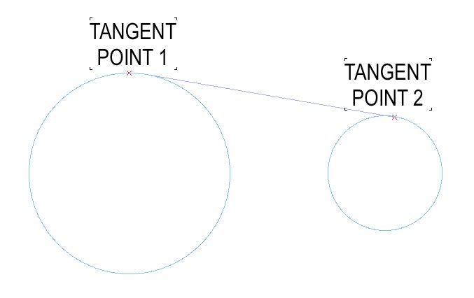

I am experiencing difficulty with ascertaining tangents of two circles, and joining the two tangent points with a line.
Say you have two circles, both of different diameters, and you want to ascertain the tangent points of these two circles, and join the two points together. I have found this task to be nearly impossible. Please refer to the attached image for an illustration of what I am trying to achieve in ArchiCAD 10.
Whenever I get a "tangent" snap symbol and click on it, I realize that the point I got is not really a tangent at all. If I were to zoom in to the maximum possible, I find that the line I created and the circle do not meet at an intersection point at all. In fact, they are apart.
This can be a problem if my floor plan is shaped as such, and I need to ascertain the two tangent points to join and form the straight portion of the external envelope of the building if it were so.
Maybe I am missing something here....has anyone experienced this similar case and found a possible solution for it? Thanks!

If you offset circle 1 by the radius of circle 2 you can then draw a line from centre of circle 2 to tangent of offset circle 1, then offset this line again by radius of circle 2.
Make sense?
Hey Stuart
I tried it and it works! Thanks!

Even though i have ArchiRuler that places dual tangentials with ease, i rarely use this feature since Archicad's chamfer/fillet tool rounds intersections in a way compatible with how i design. [NOT being an apologist for Archicad's lack of such a simple drafting aid.]
It requires non-drafting thinking.
Instead of starting with free-floating circles and placing tangential lines and then editing the circles, [lalala] you start with the lines, round their intersections [all at once if wanting a uniform radius], and offset the other side of the roadway [say] as a unit where curves and lines scale together.
