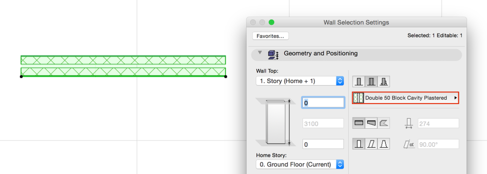

The complex profile can be further edited or stored in the Profile Manager or simply replaced in the Wall Settings dialog to the structure (composite) that was used initially for the separate segments.

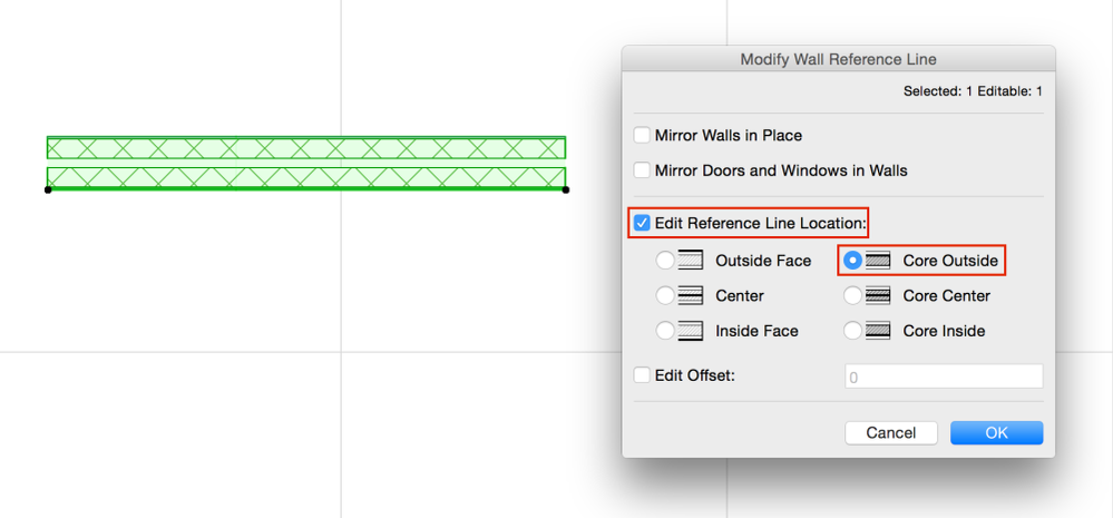

In the example above the reference line of the composites were different before and after merging. To fix this go to Edit/Reference Line and Plane/Modify Wall Reference Line….
Click OK… and done!

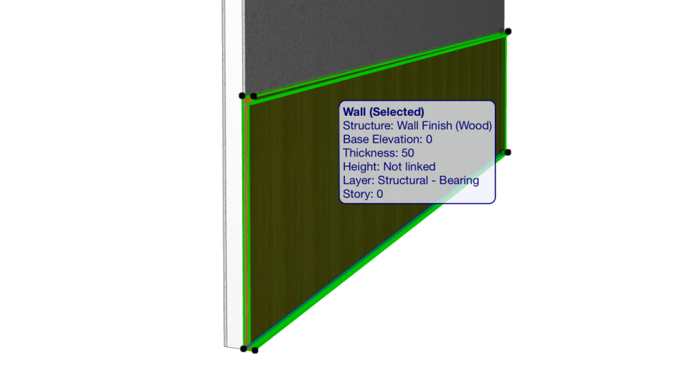

Say we have two walls, a regular stud partition composite wall and a finish part using a complex profile.

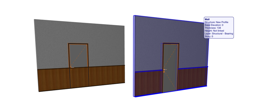

Placing a door into this combined structure will only recognize one of the walls and we cannot have an automatic, furthermore associative cut out in the finish, whereas combining these parallel walls into a new profile will solve the issue.
