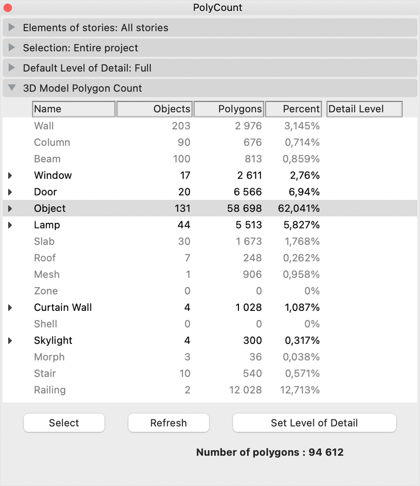

PolyCount is an Archicad “goody” add-on that helps to analyze and control the number of 3D polygons in Archicad models.
PolyCount displays the number of 3D polygons grouped by element types (walls, slabs, doors, windows, objects etc.) and their percentage compared to the complete model size.
The add-on also allows you to change the 3D detail level of certain library parts in your projects. Most objects in the Archicad library include a “3D Detail Level” parameter with "by Model View Options", "Full", "Simplified", "Schematic" and "Off". In the PolyCount dialog box, the “Default Level of Detail” function allows you to toggle between these values for all 3D objects in the projects.

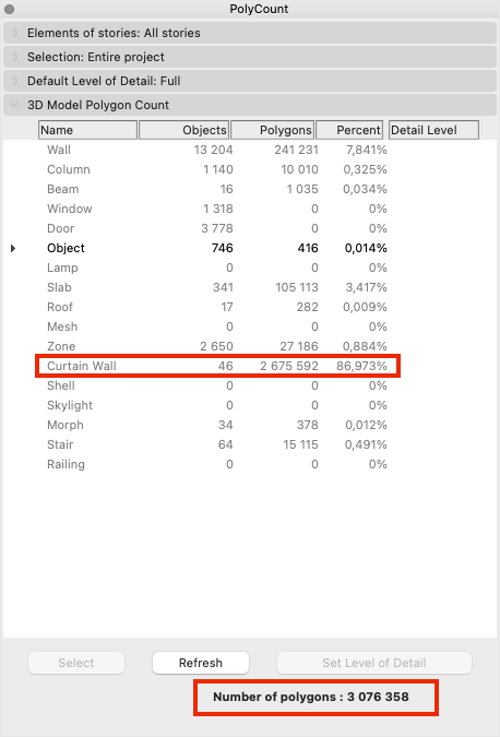

In this picture the detailed Curtain Walls make up nearly 87% of the 3D polygons, increasing the overall number of polygons over 3 million.

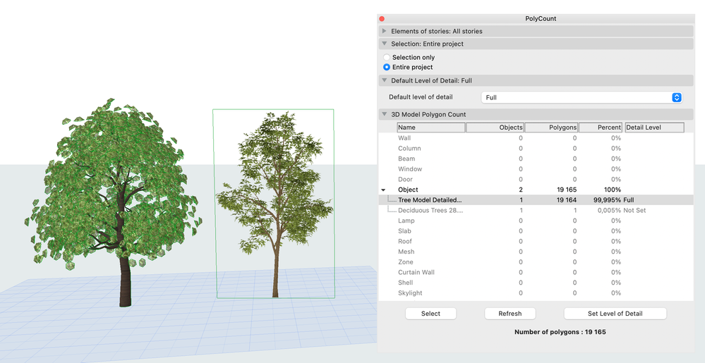

Use texture mapping and alpha-channel transparent pictures instead of physical models. This solution
can be extremely useful if you do need a large number of trees, vehicles, fences and other complex objects in the model.

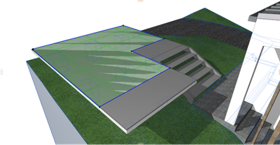

  • Overlapping surfaces (the surfaces of different elements in the same plane). These will cause a flickering effect during navigation (called Z-fighting):

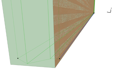

  • Far from Origin — element representation is distorted due to big distances:
