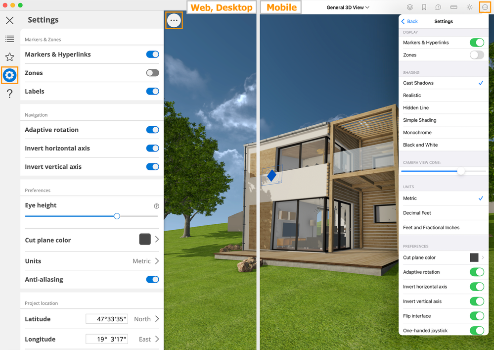

Location of BIMx Settings
In BIMx Web and Desktop, click the "..." more options menu in the top-left corner to open generic BIMx settings. The 3D display settings are located at the bottom right.
In BIMx Mobile, tap the "..." icon at the top-right corner while you have a model open.

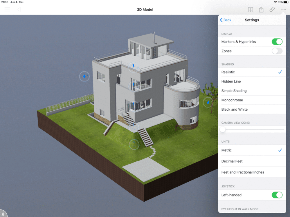

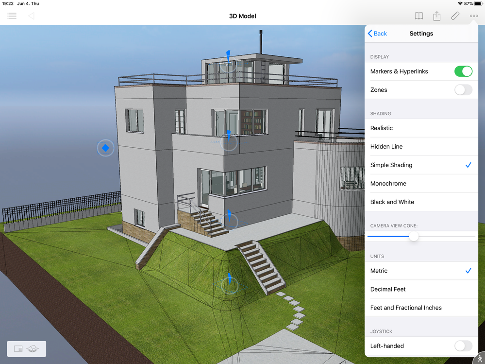

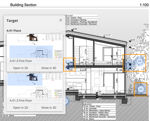

Markers & Hyperlinks
You can navigate between the 2D Drawings and the relevant 3D model views using the blue hyperlink markers in both views. The User Guide of BIMx Desktop also describes markers in detail.
In 3D, the marker icons indicate the type of drawing that will open: Floor Plan, Section, Elevation, Interior Elevation, or Worksheet views. The same applies in 2D, where data detection also works in schedules of Elements, Drawings, URLs, etc. The toggle is on by default. You can hide these blue markers by turning them off.

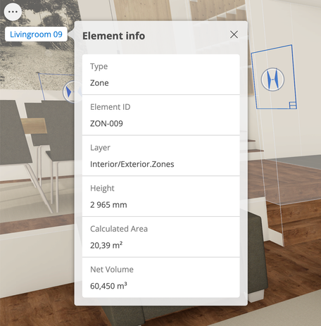

Zones
Display the 3D bodies of zones in the model and enable Zone Labels in Layouts. See their name and additional information when you walk inside.

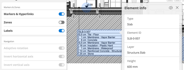

Labels
Interactive Element Labels are available on Layouts, allowing you to access element-associated information without openin the 3D model. The toggle is on by default (on mobile, it's available only in 2D). Turn off to remove blue markers from the textbox of Labels.

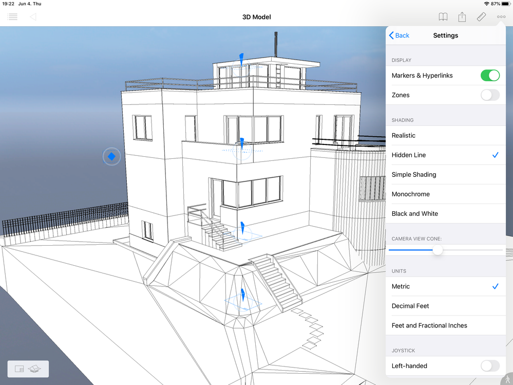

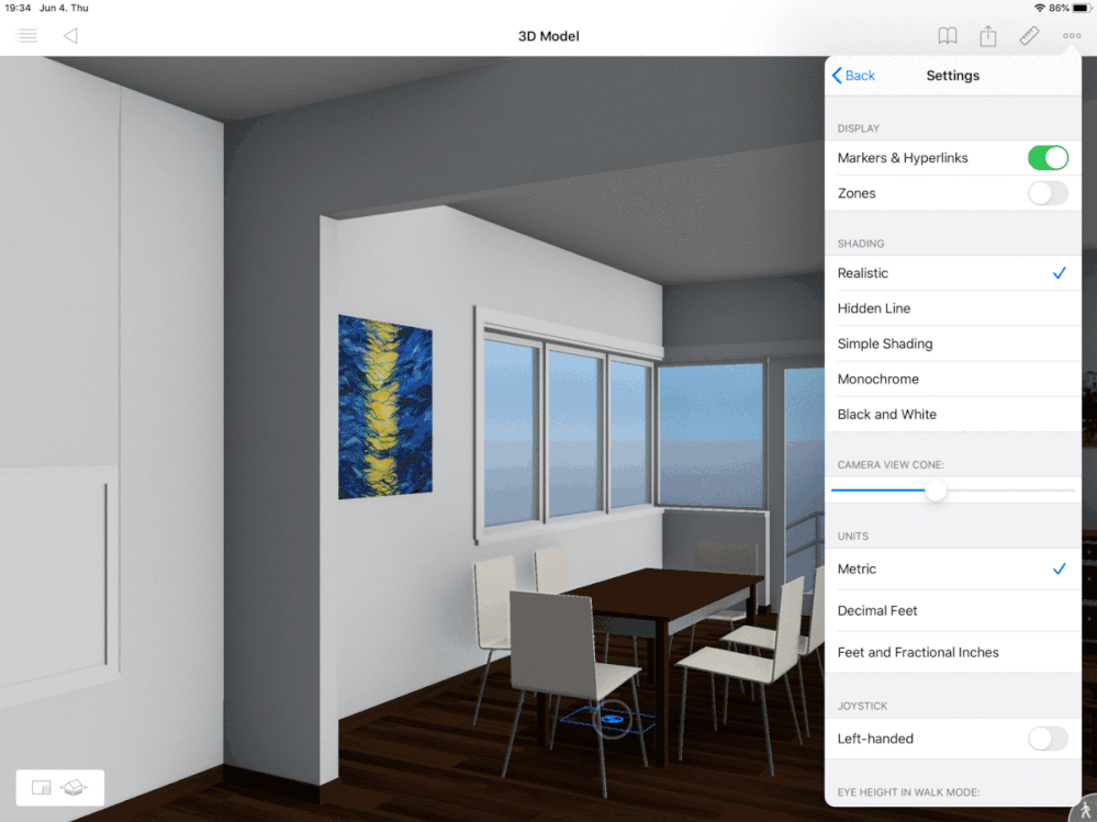

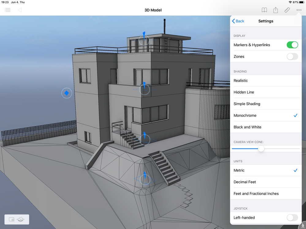

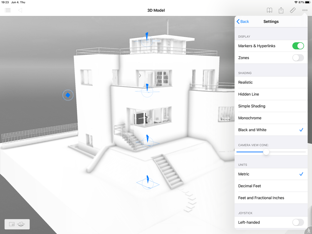

Shading

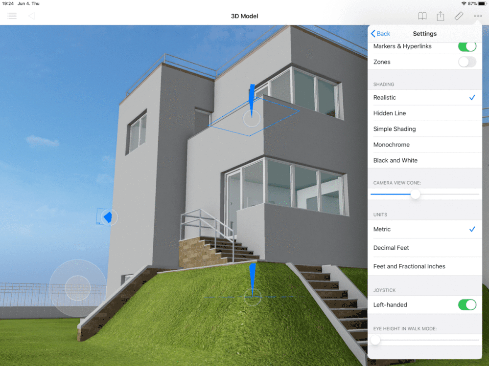

You can switch between various shading options to see your model with different textures and rendering styles:
  Textures Shading Edges Shadows
Cast shadows Realistic Ambient Occlusion   +
Realistic Realistic Ambient Occlusion - -
Hidden Line White No shading + -
Simple Shading Realistic Simplified Shading + -
Monochrome Metallic grey Ambient Occlusion + -
Black and White White Ambient Occlusion - -

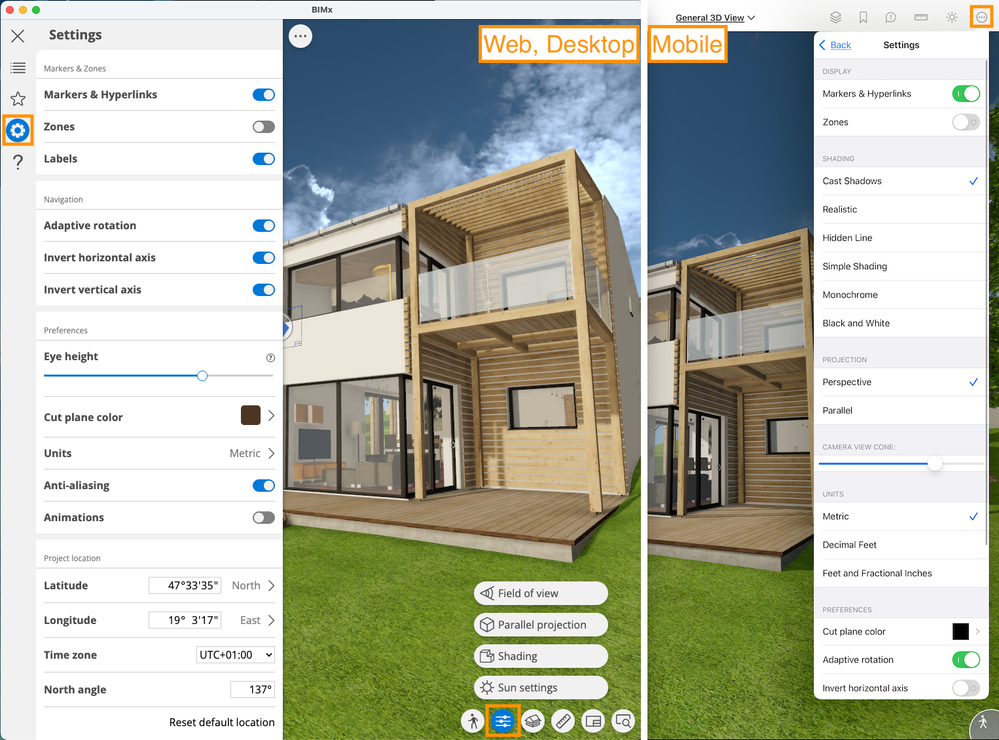

Parallel Projection
Switch between Perspective and Parallel projection. The default projection in BIMx depends on the 3D View Settings defined in Archicad. Parallel projection works with Orbit navigation, which means you can view the building only from the outside. Walk mode and Camera View Cone settings are disabled in Parallel projection.

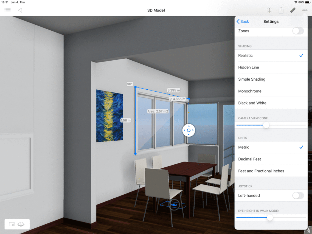

Units
Use this setting to pick what units you want the measurements to be displayed with, when you use the Smart Measure Tool.
