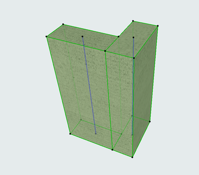

Hello. The issue is how to connect the 2 columns to form a L shape column in the corner of the building (as there is no free form design method for column - there should be.
(The Multi segment column to my understanding cannot solve this. It is for connecting different profiles of the column the one above the other, not 2 side by side.)
So, how is this done? Having 2 column is not the correct way.
Archicad 26
1 REPLY 1
Emre Senoglu
You can achieve this with a custom profile. Here's a short video showing how:
https://capture.dropbox.com/xV7k0rufuIqdtiqJ
