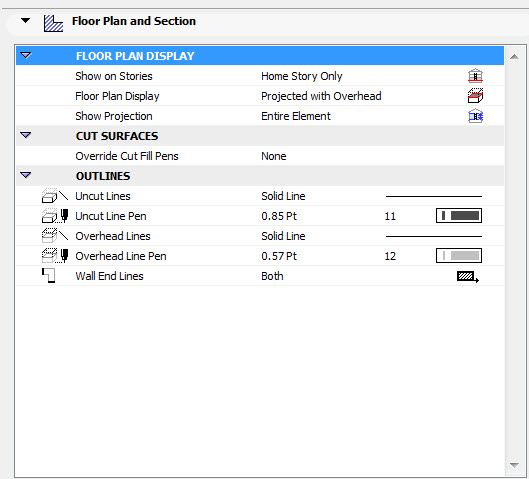

The same thing is true of Floor Plan views and Section Views of the same wall. Yes, we can use all kinds of things to get the view we want but the essential problem is that two kinds of views are being controlled by one setting, and this is what generates the need for so many compensations.
Not that the compensations are not useful for unique situations, and I am glad to have them, but why not just add settings in the Floor Plan and Section dialog box that are for Floor Plan AND Section? As it is, the menu says Floor Plan and Section, but the settings are actually only for the Floor Plan. If there was a menu for how you want it to look in Floor Plan and also a menu for how you want it to look in Section, all in that same place, it would eliminate a good deal of the compensations that are necessary to make it look like you need it. This sort of thing never seems to be on the agenda for new versions. Instead, it seems to always be about how to invent another compensation. This may not be the case, but it does seem that way to me.
