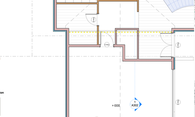

I am having an issue in plan view with layers showing through each other. I have a floor that is raised above another that by a couple feet and the lower of the two is showing its outline.
I can't seem to get the layers to hide one another when overlapping.
I can see the outline of a layer above the floor plan cut line as well.
Thoughts? I have used the display order without success.

You can set the Floor Plan Cut Plan settings to display items above or below the current storey and set the height where the plan is cut through the current storey.
You can also set how the individual elements display relative to storey in their parameter settings which is where things can get confusing.
