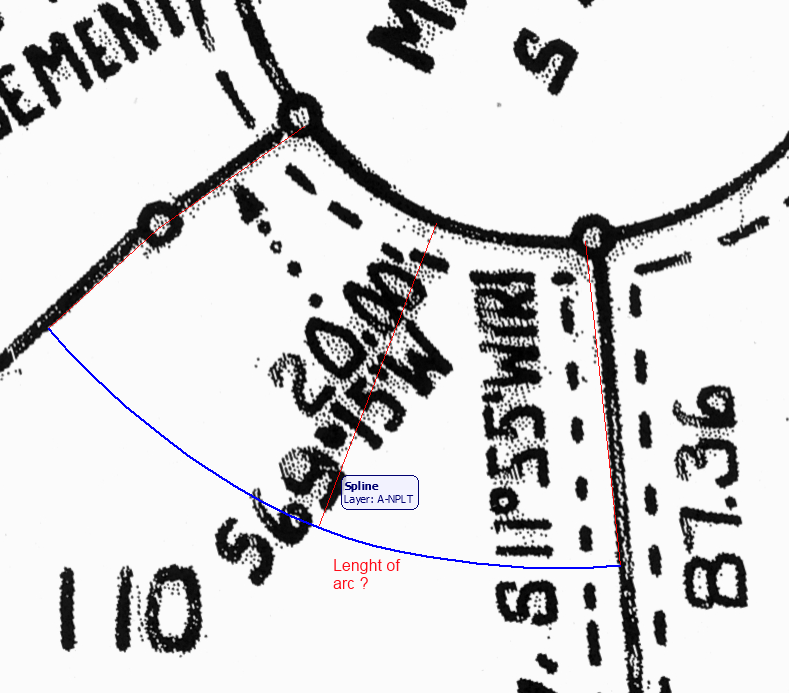

And can't seem to figure out how to get AC to measure the length
of this arc. either with spline or polyline.
I'm sure I missing the obvious but have run out of ideas.
I've tried holding down ctr/alt keys etc,etc to get it to add all together but each point I click resets length to zero again.
And bending straight line so far gives no joy.
help would be great.

Window->Pallets->Element Information
and click on the second icon from the left.

2011-01-04 11:25 PM
that does not involve trig or calculus.
C is the central angle
R is the radius
∏ is Ludolph's constant
(3.1415926....)

Peter wrote:Be sure to draw the arc counter-clockwise, or the angle and length will be wrong. Looks like a bug.
Select the arc then go to Window->Pallets->Element Information and click on the second icon from the left.

I could not reproduce the clockwise counterclockwise bug
in either AC 10 or AC 12.
Could it be that what works correctly in AC 10 or AC 12 got busted in AC 14 ?
If you still have an AC version earlier than AC 14, see if it works correctly in that version.

David, I tried both directions with the spline tool (14) and Element Info gave me the same length.
zpf, Could not get dimension tool to measure arc, my ignorance there I suppose.
Peter, thanks for the formula, took me a minute, but I got it.
Thanks again everyone.

David wrote:I get this bug too.Peter wrote:Be sure to draw the arc counter-clockwise, or the angle and length will be wrong. Looks like a bug.
David
I also get it if I draw counterclockwise, then mirror it. The angle of the mirrored arc will be incorrectly reported.
So I send this to GS.
