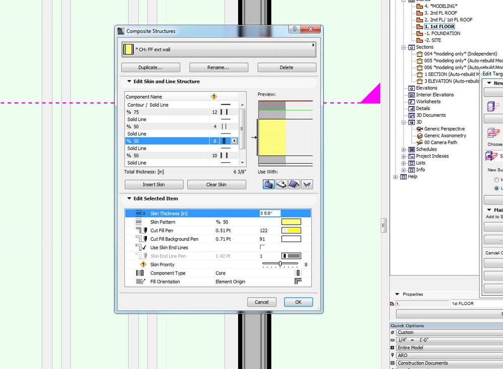

Line types and fills displaying incorrectly on a composite
I searched the forum and checked everything I could, to no avail. I've created a composite, and while the preview reflects the line type and fills that I've selected, these change when I am viewing the composite in plan (see attached screengrab). This is also true when I view the composite in section, even though I have deselected the override "uniform pen" check boxes within the section marker. Can anyone help me to chase down the toggle I must have missed?

I would start by looking into the Model View Options, it seems like you have some fill overrides going on . >Document > Set model view.
...that was my first thought, too. But no, no overrides in the MVO at all. Thank you, though! Other ideas?

How about the pens?
BTW, you really should start using View Map views instead of Project map views. View Map views are saved with settings and therefore are the same every time you open them.
The project Map view are "raw", they have no ability to save settings and so show you whatever the last settings were - regardless of why or where those settings came from.
To get a grip on this, save this view into the view map, review all the settings of the saved view and check the settings of the pens etc. This will help you with consistency.
For example if you have looked at a section and then returned to this Project Map view of the plan, you will have inherited whatever settings were current in that section.

Regarding the line and color settings, I am using the same pen set throughout.
It seems like there is an override somewhere I've missed-- the only change I can generate in the plan view is that changes in fill pattern as set in the composite are reflected in the plan view- albeit, they are shades of gray rather than whatever color I set them to be in the composite.

Other items to check.
- Trace Reference off/on?
- Renovation Overrides?

Thank you all, for your responses- the solution was fairly simple, but not one I've dealt with before- I'm at a new office and using a new template, and the default setting of the "Wall Selection Settings" -->"Floor Plan and Section" --> "Cut Surfaces" check boxes for "Apply Structure's Settings" was deselected; hence, a very local overwrite, per-wall.
