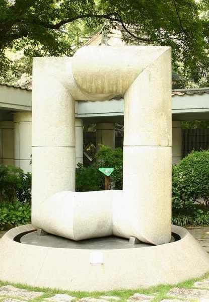

I have a problem now. I don't know how to draw such LOOPED Cylinder sulpture. The diameter of tube is around 300mm. I only know to create a horizontal tube by using proflier but it cannot bend the tube upwards by 90 degree. Could anyone teach me? THX a lot.

I couldn't resist this one.
Attached is a simple library part for the sculpture.
It is very basic. I haven't tweaked the code for ease of use. It is placed by it's center elevation (not the bottom), but it is stretchy with a parameter for the radius.
Please feel free to use/study/modify it as you wish.

Olivier wrote:Oops. Sorry about that. I didn't look at the signature. I don't have time to open AC7 to make a compatible one, but you could copy/paste the code using a text editor. There is only one parameter to set up which is named tube_radius
Hi Matthew, nice work, but not sure if Larry can open it because it seems he has AC7.
I have a free object that allows to do that, just by moving some hotspots, in 3D view.
Unfortunately it is for AC8.
In fact, why don't I just paste the code here...
ht = (zzyzx - 2*tube_radius)*0.5
wd = SQR(A^2 + B^2)
angle = ATN(0.5)
x1 = A*0.5*COS(angle)
x2 = wd - x1
y1 = x1*0.5
rotz angle
TUBE 2, 8, 111,
0, 0, 901,
tube_radius, 360, 4001,
0, 0, -1, 0,
0, 0, 0, 0,
0, 0, ht, 0,
x1, y1, ht, 0,
x2, -y1, ht, 0,
wd, 0, ht, 0,
wd, 0, 0, 0,
wd, 0, -1, 0
mul 1, -1, -1
TUBE 2, 8, 111,
0, 0, 901,
0, 0, -1, 0,
0, 0, 0, 0,
0, 0, ht, 0,
x1, y1, ht, 0,
x2, -y1, ht, 0,
wd, 0, ht, 0,
wd, 0, 0, 0,
wd, 0, -1, 0
