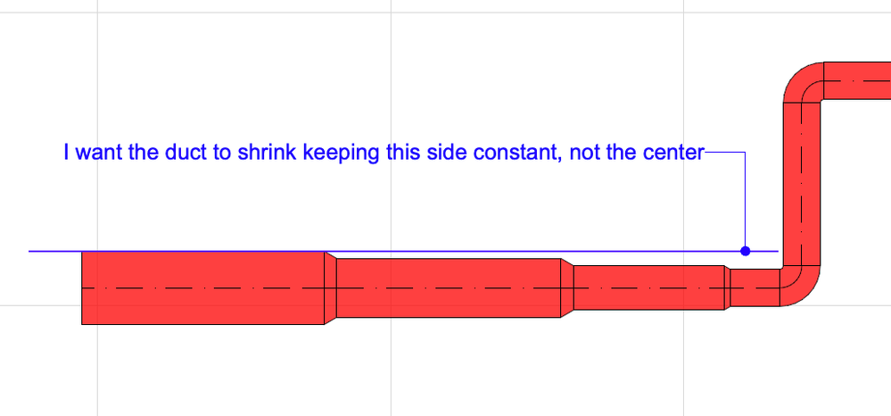

Hi, I would like to know how can we set the variation of the section of an Air Duct to take place at a side of the duct and not at the center as seems to be the default setting that doesn't seem it can be changed. At least I did not find any setting for this.
I'm attaching an image to illustrate what I want to achieve.

Hello @Achille Pavlidis ,
In the upcoming version, a new feature will allow you to select any edge from the duct.
Thank you!
Hi @Lina-Zouaghi,
You mean next version 28 or next update for 27? Which is happening earlier?
AC 28 INT 5200/WIN 11
@Mahmoud Qenawi This feature will be available in version 28.
@Lina-Zouaghi Really?! I was sure you meant the next hotfix!
We have to wait for AC28 to have this very basic function, that was available until AC26?
We literally never design air ducts that do not keep one side constant!
Basically the new MEP is useless, this is utter disappointment
