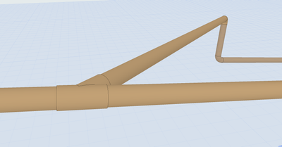

I understand that part of the design is going to be hard to achieve, so feel free to let me know anytime you find something you are not able to do and I will try to help.
Just a few answers/remarks to the points you raised:
  1. What is missing? There was a unification of Tee and Wye elements are you referring to that?
  2. Yes, this is currently missing. We are thinking about the best way to solve this. What makes it a bit complicated is that we will have to retain the correct labels after the removal of the node. What you can do already in Archicad 27 is moving a node to another node, thus making it disappear.
  3. Currently it works the following way:
    1. If a route has elements on a story, and the Show on Stories option is set to 'All Relevant Stories', all of the route elements will be displayed on each story
    2. If a route has elements on a story, and the Show on Stories option is set to 'Home Story Only', all of the route elements will be displayed on its current story
    3. If you only want to display elements that are on each story, you should create separate routes for each story.
  4. It is possible that I did not understood this one, so feel free to correct me, but I believe that in the below picture everything is how you described. The branch element is also sloped and after the vertical pipe it also continues in a sloped fashion.
