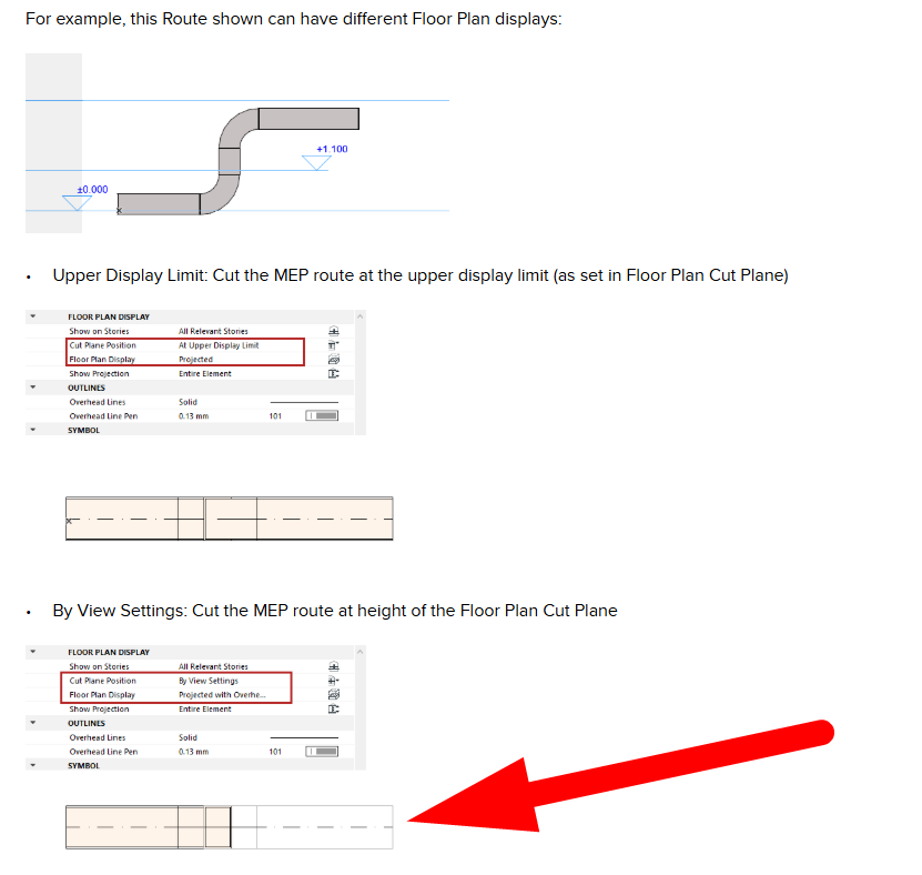

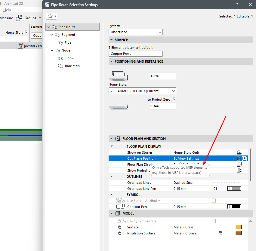

Have anyone actually made this work? The floor plan cut plane does not give me the option to show only the part under the cut plane (as it is described in the Help menu).

MEP library was missing.
