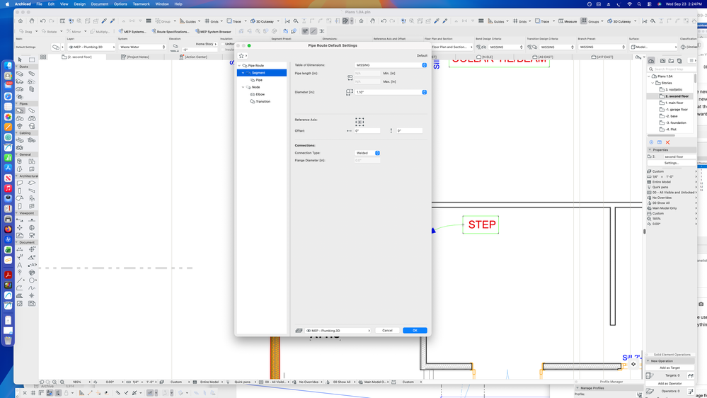

The issue arises when you open an old file in the newer versions.
The preferences table is missing because it was never set up in the first place.
Go to the MEP Route Specifications (could be that those are missing from your Work Environment if you also took that with you from older versions).
In there you have to put in the default sizes you want to use. Of course you can also just export everything from the default template and import it in your file.

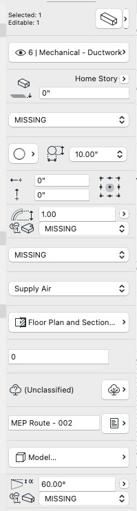

Having the same issue except that the last file we opened, still has the MEP preferences tables attached, so something went wrong when we opened a new project file.  Below shows that the table of dimensions is missing in the pipe segment window, (not shown) the T-element placement default is missing in the Pipe Route window, and when we try the tool, a "the former Preference table of this too has been deleted" window pops up; telling us to choose another preference table. My question is how do we "choose another preference table"? or "export everything" from a default template and import it into" our file?
