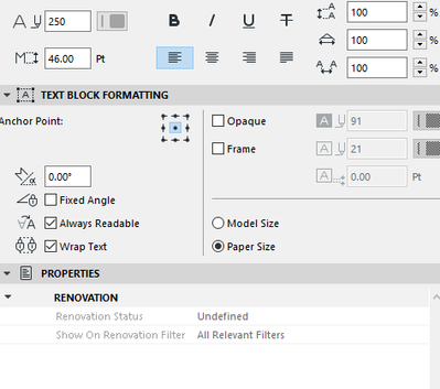

Hello,

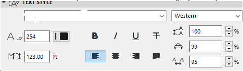

I have been reading in variety of forums to try and get to the bottom of this, but I am growing weary. My issue is that we have installed a custom font that we use for marketing/branding purposes in our program, but it is not displaying true (true with reference to how Adobe programs display the same font ex. Illustrator/Indesign). The font is in ".oft" formatting. I am not sure if this is the issue as I couldn't find any information on whether or not Archicad had a preference to this. I had also tried to convert it to ".tff", but it didn't matter. The font is not missing (it does not show like this [font] ). The only way I could get it to match exactly was by using was by adjusting the spacing in Archicad and stretching the font slightly... this is not ideal. If I change the font point size I would have to readjust these numbers with a reference PDF with the actual font as reference.
We use Windows 10.
Any thoughts are appreciated.

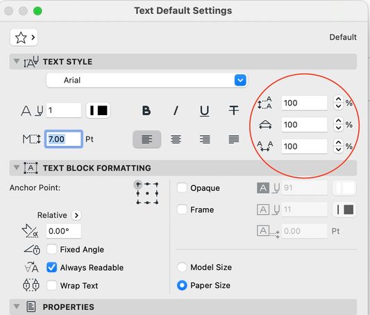

Hi.  A similar question was asked recently.  Barry pointed out in his response there that some of the text settings are not visible in the editing/formatting bar shown in your screenshot.  You have to look at the Text Tool settings themselves - attached screenshot.  In your case, make sure that all of the circled settings are set to 100%.  Note that if you do want to use these settings to change kerning etc... they are % values ... and so you would not need to readjust anything for different point sizes.
Any new text placed in a project uses the last-set values in the Text Tool... so it is worth checking these settings from time to time.  In the case of already-placed text, select the text, then press ctrl-T / cmd-T to bring up the settings dialog to correct the settings.

Hello Karl,
I had manually adjusted the font for those values in order to match the marketing PDF I was referencing. I loaded in the PDF to scale that was exported from Illustrator into the layout space to work on top of to ensure it matches.
After further investigation I believe the issue it with the text tool itself. See below:
The text does not sit perfectly in the text box. Is there a way to fix this? The spacing between the rows of text is also not accurate.
Thank you for the help.
