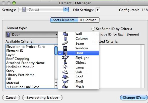

Greetings - I don't think this is possible, but it's worth the question:
Is it possible to renumber zone room numbers similarly to how element IDs can be renumbered (using the ID Manager)? Or, is there a tip/trick to pick the zones in the desired order and reassign the room numbers accordingly all at once?
Thanks, Scott

strangely enough, this is not possible. However, the Total Zone can show the ID of a Zone. Then you can use this as Zone Number.
To control the order of the ID with the Element ID manager, you need to select the elements (Zones) in the desired order: the first selected will be number 1 the second number 2 and so on and then run the Element ID Manager.

I enjoy using your Total Zone, and can see the inputs for Zone ID and Room Number in the Total Zone area of the DB, but AFAIK, Zones do not appear in the ID Manager list for reassignment of IDs. Please see the attached screen shot of available tools for ID management. Could you please elaborate how to achieve renumbering ID/Room Numbers using your system? Thanks, Scott
