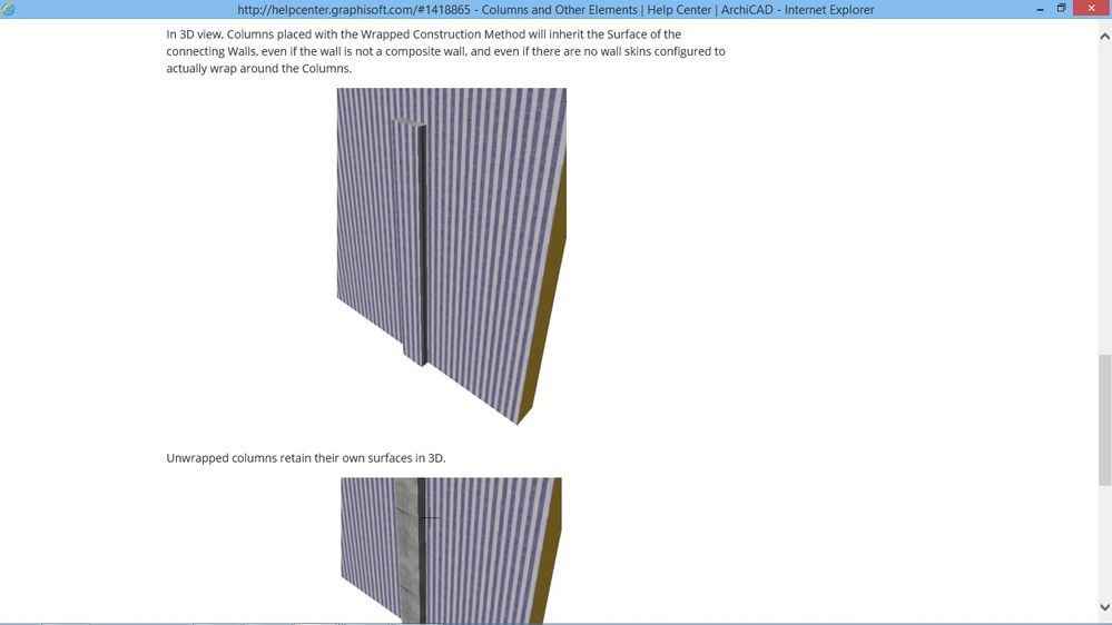

I use to solve the column and wall surface material matching by using the wrapping ON option inside the column general settings sub rollout.
But now its not function in current archicad20 especially for normal wall. For composite walls it works. Why So? Help file says it works but its not working.
I have attached the Help file page for reference

Wrapping works for skins which are set to "Other" &/or "Finish" Since basic walls do not have this option, they are "Core" walls. That is the reason why wrapping does not work for basic walls. Also, if you set all skins of a composite wall to "Core", wrapping will not work either. Please see attached screenshot.
