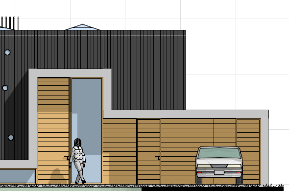

I want the wall and the door to have/appear in the same material (vectorial hatching), in 2d elevation (it´s right in 3D).
What happen is: I choose a material that has a vectorial hatching vertical. When I choose the same material on the door, the hatching show horizontal (on the door)??
How to I get a material to show the same direction on both walls and doors(windows)?? without having to make a copy and turn it 90 degree)

You may need to use the Align 3D Texture command to change the direction of the texture [fill (hatch)] on the door.

Ok, but I do not understand why a specific material appears different on a wall then a door? Vertical is vertical, and horizontal is horizontal..

Well, i can not understand that one material is appearing on two different ways, depending if you use it on a wall, or a door? If I choose a woodsiding that has a hatching (horizontal), why does it become vertical on the door.
Can a door take control over the material you choose?
In some cases I had to make a copy of the original material, only to make it the opposite hatching of what I really wanted, then it shows as I want. But that is not that way to create a BIM..
Look at the attached image - the doors should have a vertical sidings as on the wall..
So, who decide the hatching of a material, the door (the object) or the material??

Orientation is set with the object. My advice is to make materials with separate orientations to cope.

The wall is an element of Archicad and the hatching will behave as you expect it to (can be manually moved and rotated in 3D - "align textures").
There is no script as such for a wall - it is controlled directly by Archicad.
The door is an object scripted by someone who may have altered the orientation of the textures in the door script - either intentionally or unknowingly.
So they can be completely different as you have experienced.
