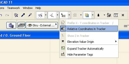

My measure tool (M) used to measure from point A to point B, now it only measures from the origin. How do I set the behaviour back to what it used to be?

Make sure 'relative co-ordinates in tracker' in the tracker settings is enabled.

Thanks!
