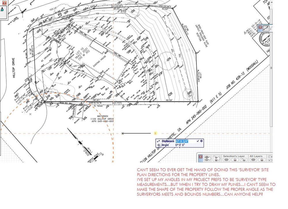

I'm trying to input the surveyors site property information.
A fellow Archicad guru explained it to me one time but I can never remember what I'm doing wrong here.
I've set up the project prefs to read the "degrees, minutes, seconds" for the angles but when I type in the numbers...its not right.
Could use some help here.

Rob,
Use the surveyor's units and decimal feet not Degrees Minutes and Seconds.

dohhh....
thanks sir.
i'll give that a try.
