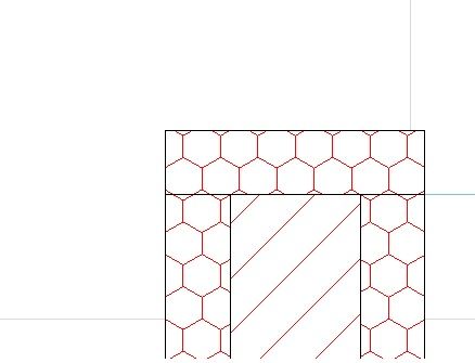

Hello,
I would like to merge wall with thermal insulation on both sides with a thermal insulation on upper side as its shown on picture, so there wouldnt be that dividing line between them.
Is that possible, and how?
thanks!
2 Replies 2
Set the end Wall´s priority 2 values higher than the highest value of a skin in the composite wall.
rocorona
Did you try the WALL END tool ?
