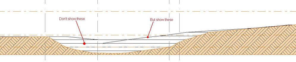

I clearly haven't explained myself properly.
In a mesh, there are three different 'ridges': 1. the Outline, 2. User defined ridges (typically your contours), and 3. automatic ridges (the triangles).
You can turn off the automatic ridges by selecting "Show User Defined Ridges" as opposed to "Show All Ridges". There should also be a selection for "Show Outlines Only" - but that's not what this poll is about.
When you have "Show User Defined Ridges" selected, your contours will still show up in elevations & sections with depth as horizontal lines (see screenshot). It's these lines I want to be able to 'hide', whilst still displaying the outline (yes, in both plan and section).
That's what this poll question is asking. I was hoping to avoid a lengthy post as it doesn't encourage people to read it, but I hope this makes it a bit clearer.
