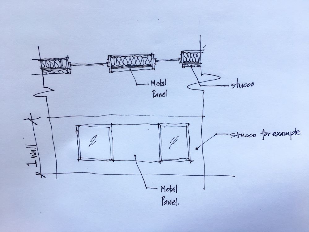

Hey guys,
Still new to Archicad so I'm wondering how to do this. I want to draw a wall, say with a stucco exterior material. Then I want to place two windows a few feet from each other.
Now, here's the hard part (for me at least). I want to change the stucco between the two windows, to a metal panel material. three area above and below the metal panel is still to remain as stucco.
How can I achieve this?

The easiest way would be to draw a morph between the windows in an elevation view, and SEO out the stucco, if you wish. https://youtu.be/MnDaOYtoGc4 for a similar example by Eric Bobrow.

Thank you Richard. I'll check it out.

Perfect! That video definitely helped.
