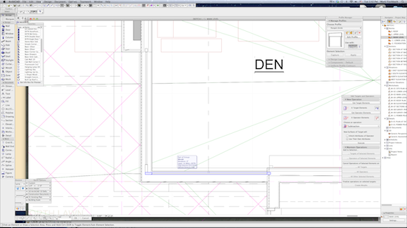

I am trying to model a corner pocket door (pocket doors with operable panels that meet at a 90º corner). I tried using two pocket doors with door frame size of zero (to make frame at corner disappear) but no luck.
I Finally used solid element operations to cut whole in wall and modeled door panels from walls/morphs/slabs. Any advice on a way to do it so that the doors show up on schedules and behave like doors would be greatly appreciated!
Screen shots attached.

Here's a solution that works well for corner pocket doors:
1. Insert two pocket doors in two walls
2. Position doors so that door panels meet as they would in corner door.
3. Create cutting body that cuts out messy party of wall at meeting corner. Do NOT do a solid element operation to subtract the cutting body from the walls. Let the priority connections cut the wall. If you do a solid element operation, the pocket doors will be cut as well.
As long as the cutting body is on a non-showing layer, the doors will appear in plan, elevation, 3d and schedules properly.
