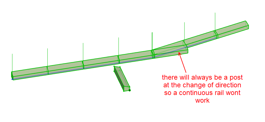

I just had a thought.
Maybe the railing will work if you use a custom post for the curb/gutter module, basically a long short (height) post.
You can set the panel length to the module length.
Almost works ...
Now the question is can you save a post with the origin not in the center?
Or can you offset them in the railing?
I'll let you play around with that.
No doesn't really work.
I edited the GDL to move the curb of centre, but there will always be a post at the change of direction.
You can turn it off, but then there will be a gap, so you need a railing for each straight length.
Sorry, just thinking out loud.
It seems there may be an Archicurb object after all if you get a link.

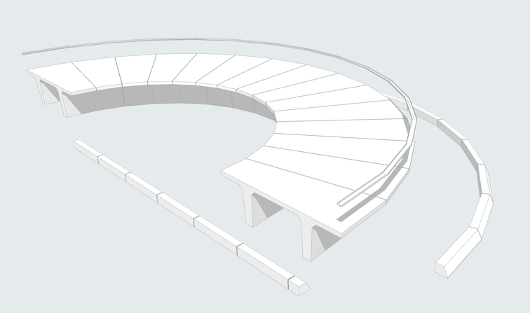

cuba
Hello Karol,
I created two param-o objects for this purpose: a linear element and a segmented arc. This works with any complex profile. These objects are graphically adaptable (as long as you don't put them in a slope etc...).
With the linear element, it is possible to extract the length and thus determine the number of elements. With the segmented element, as far as I know, it is unfortunately not possible to extract all the parameters (maybe in the future). You can create an additional parameter for this and set it per object to be listed.
