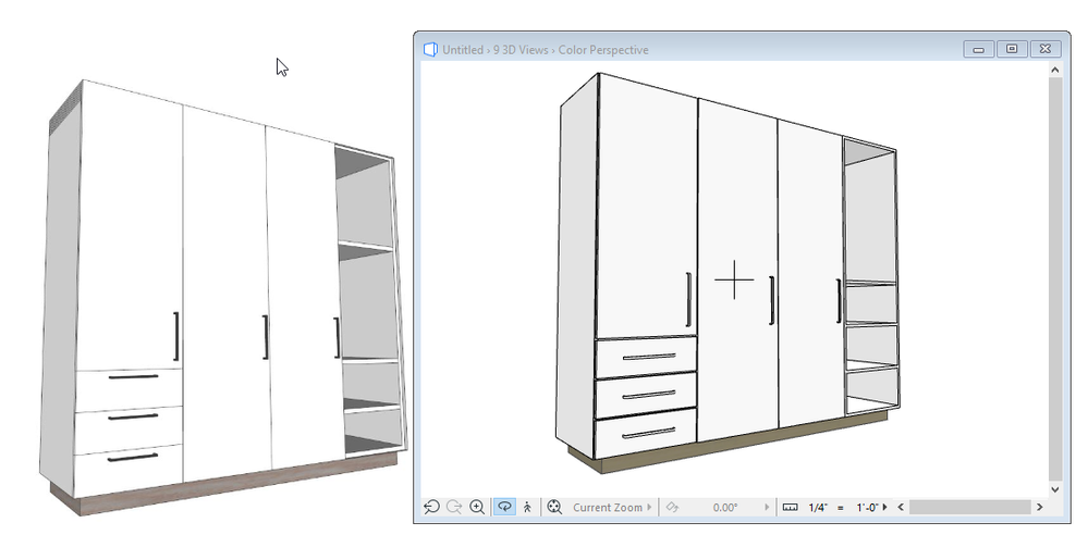

See attached joinery piece that I made in SketchUp for an old project (before we switched to ARCHICAD). This is the level of detail required in our ARCHICAD residential projects but I'm unsure the best way to go about it.
There is nothing in that image that wouldn't qualify as basic modeling with ArchiCAD.
Hi Steve,
I agree - it is basic modelling in ARCHICAD
I guess I'm after advice what would be the best way to model something like my attached image from sketchup. Morphs? Walls? Slabs? A combination of all 3?
Steve Jepson
For that specific cabinet we have some out of the box ArchiCAD cabinets that can do that.
Office Cabinet 21 on the left
Tall Cabinet 21 for the two in the center
Cabinet Tall Double Door 21 on the right
Other cabinets might also do the trick for you. They all have several options you can use to get what you need. Pick the cabinet that looks most like what you want first, and configure it to be how you like it.
If it is really nothing like what you can configure it is not that hard to model them from scratch. It depends on what you need the models to for. Making Shop drawings, or must making something that represents the cabinet you would like to use.
The toe kicks are turned off for these and some walls were used for the toe kick.
